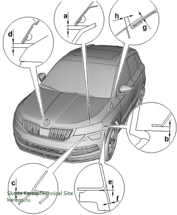

Przód Skoda Karoq
-a- = 3,4 mm
-b- = 2 mm ± 0,5 mm
-c- = 1,5 mm ± 0,5 mm
-d- = 3,4 mm
-e- = 0 + 0,5 mm
-f- = 0,5 mm ± 0,5 mm
-g- = 1,4 mm ± 0,5 mm
-h- = 2,8 ± 0,5 mm

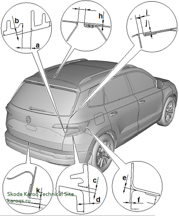

Tylna część nadwozia
-a- = 3,5 mm ± 0,5 mm
-b- = 1 mm ± 0,5 mm
-c- = 1 mm ± 0,5 mm
-d- = 1,5 mm ± 0,5 mm
-e- = 1 mm + 0,5 mm
-g- = 4,5 mm ± 0,5 mm
-h- = 1,5 mm + 0,5 mm
-i- = 3,5 mm ± 0,5 mm
-j- = 1,3 mm ± 0,5 mm
-k- = 5 mm ± 0,5 mm

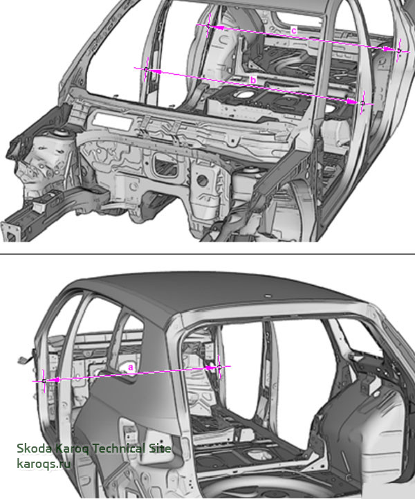

Środkowa część
Wymiar między słupkami A, B i C.
-a- = 1499 mm ± 2,0 mm
-b- = 1537 mm ± 2,0 mm
-c- = 1481 mm ± 2,0 mm

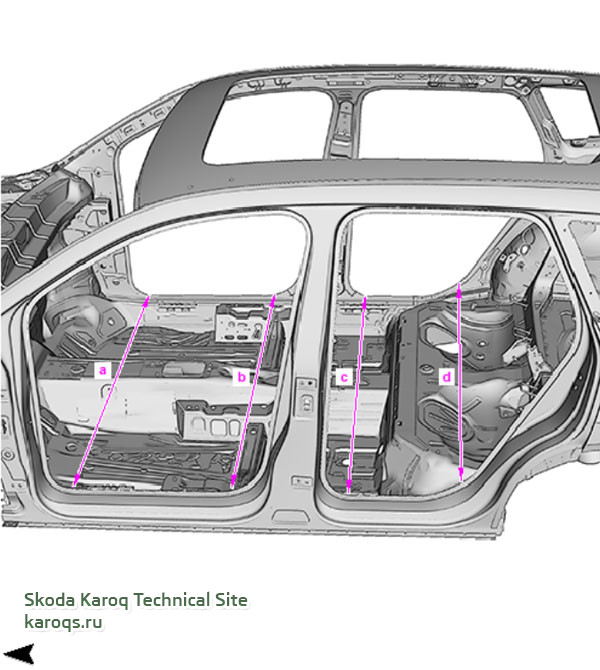

-a- = 1464 mm ± 2,0 mm
-b- = 1469 mm ± 2,0 mm
-c- = 1469 mm ± 2,0 mm
-d- = 1464 mm ± 2,0 mm

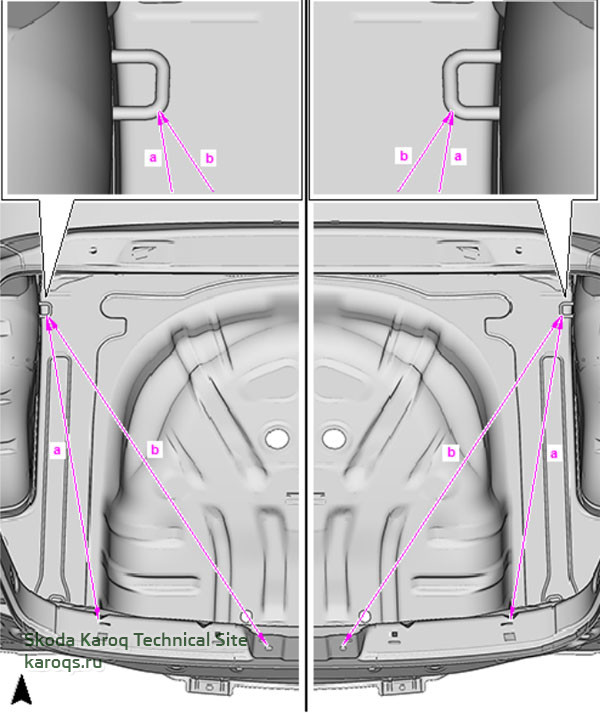

-a- = 1309 mm ± 2,0 mm
-b- = 923 mm ± 2,0 mm
-c- = 1170 mm ± 2,0 mm
-d- = 1353 mm ± 2,0 mm
-e- = 1060 mm ± 2,0 mm
-f- = 1327 mm ± 2,0 mm
-a- = 684 mm ± 2,0 mm
-b- = 833 mm ± 2,0 mm

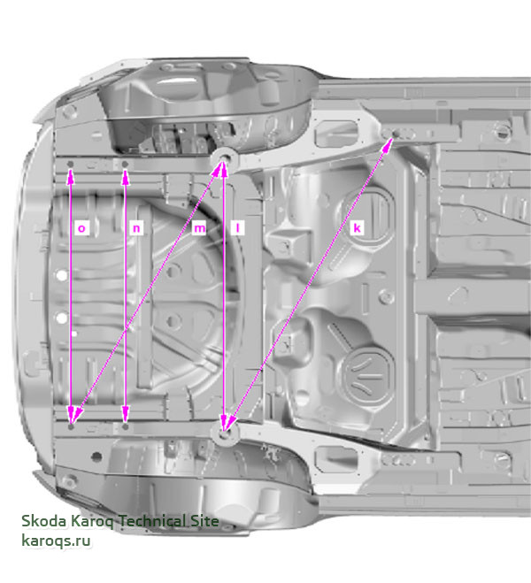

platforma pośrodku
-f- = 1076 mm ± 2,0 mm
-g- = 1885 mm ± 2,0 mm
-h- = 1447 mm ± 2,0 mm
-i- = 1220 mm ± 2,0 mm
-j- = 1497 mm ± 2,0 mm Platforma nadwozia,
nadwozia z tyłu
-k- = 1306 mm ± 2,0 mm
-l- = 1021 mm ± 2,0 mm
-m- = 1146 mm ± 2,0 mm
-n- = 987 mm ± 2,0 mm
-o- = 986 mm ± 2,0 mm
